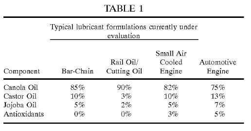

Some here like to push the boundaries though, and I'd like to hear the tears of the chap who'll run straight veggie-oil like Canola in the Pig. It'll carbonize in no-time, and will seize the its internals. Pls post a pic?
