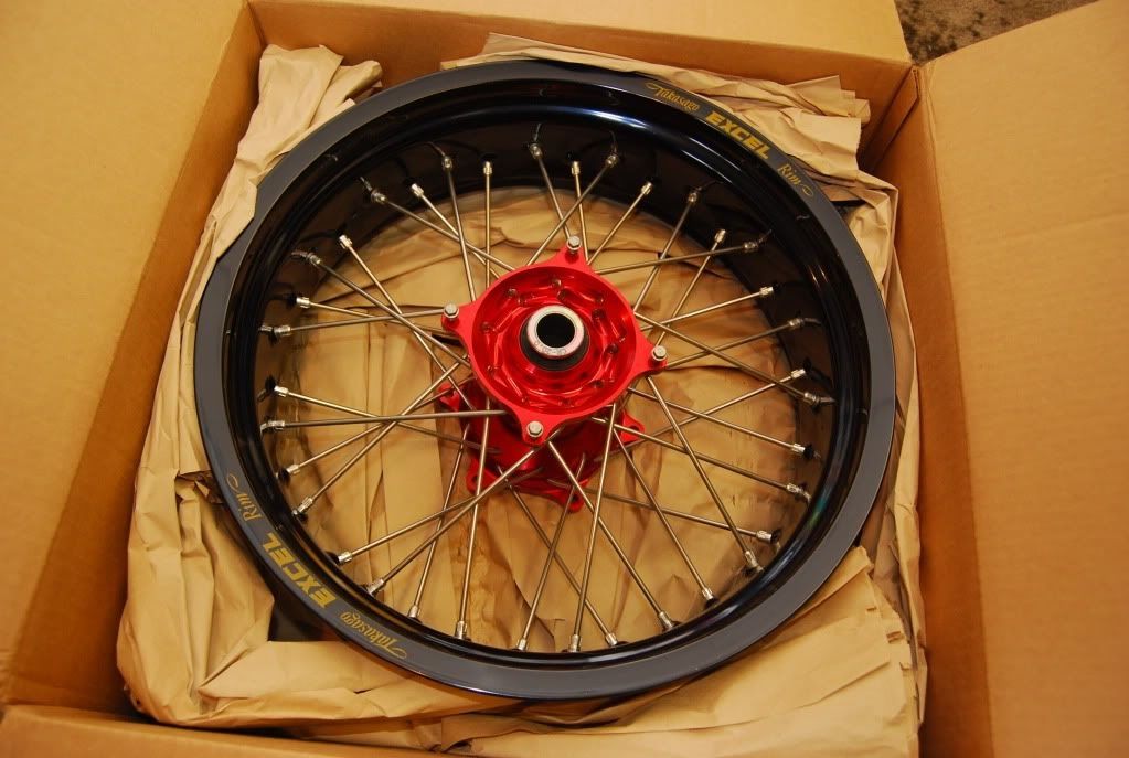

Post  rikco on Wed Feb 20, 2013 11:53 pm
yes i still check em now before i go take a ride listen up
i had more tears about the rear wheel that was only 140 kilometer old pale Crying or Very sad
4 weeks later i was back up and running, new rear wheel from the usa and the 2nd hand swinger from the uk rider

Post  Zoro on Thu Feb 21, 2013 1:49 am
Where's the best place to buy those Excel rims from?
I love the look of them

Re: Chain adjuster broken off (what to do best?)
Post  rikco on Thu Feb 21, 2013 4:47 am
look for a 2nd hand set on forums or ebay, new price is way to high
mine are from a crf

Post  Mauser on Thu Feb 21, 2013 8:10 am
rikco wrote:look for a 2nd hand set on forums or ebay, new price is way to high
mine are from a crf
Are they 18" rims same as stock ?, they do look pretty must say Very Happy

17inch (3,50'' front 5,00'' rear)
