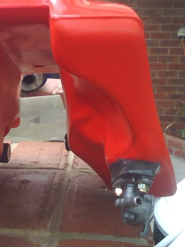

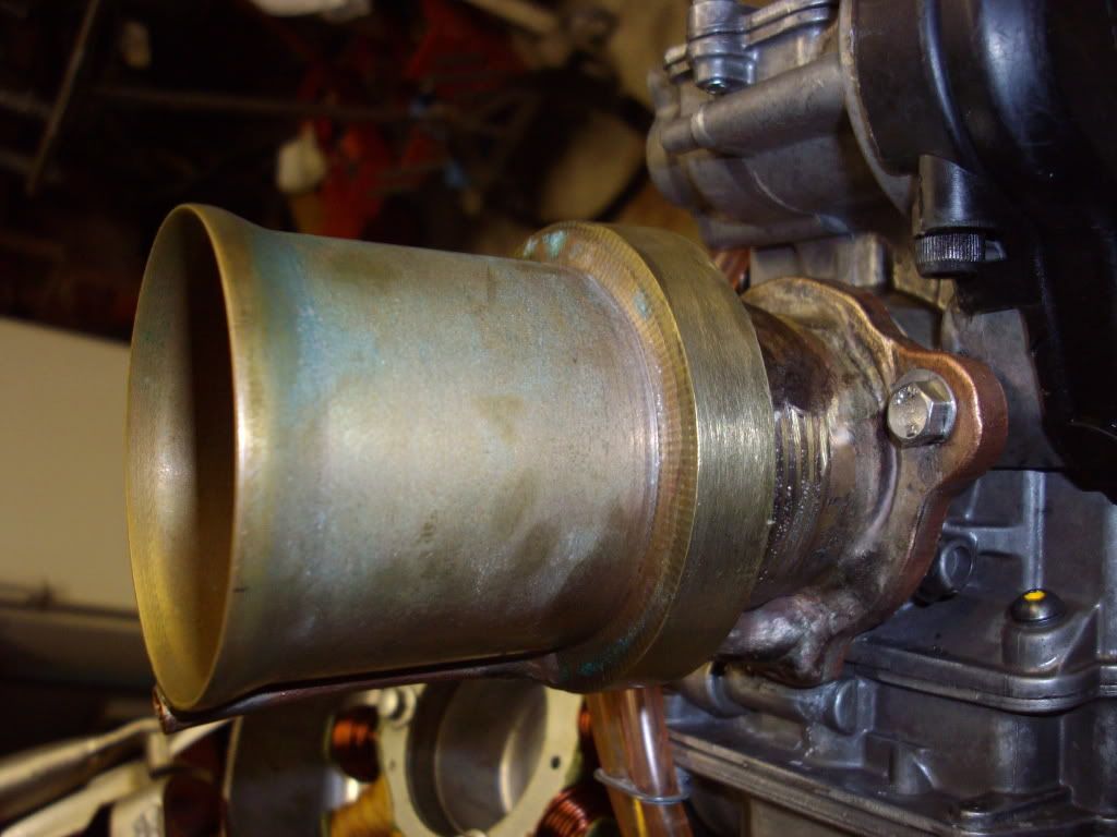

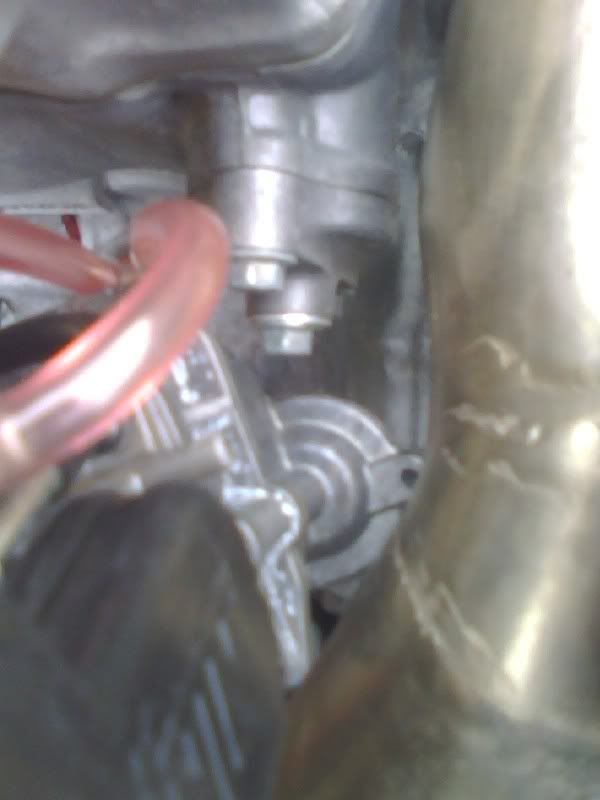

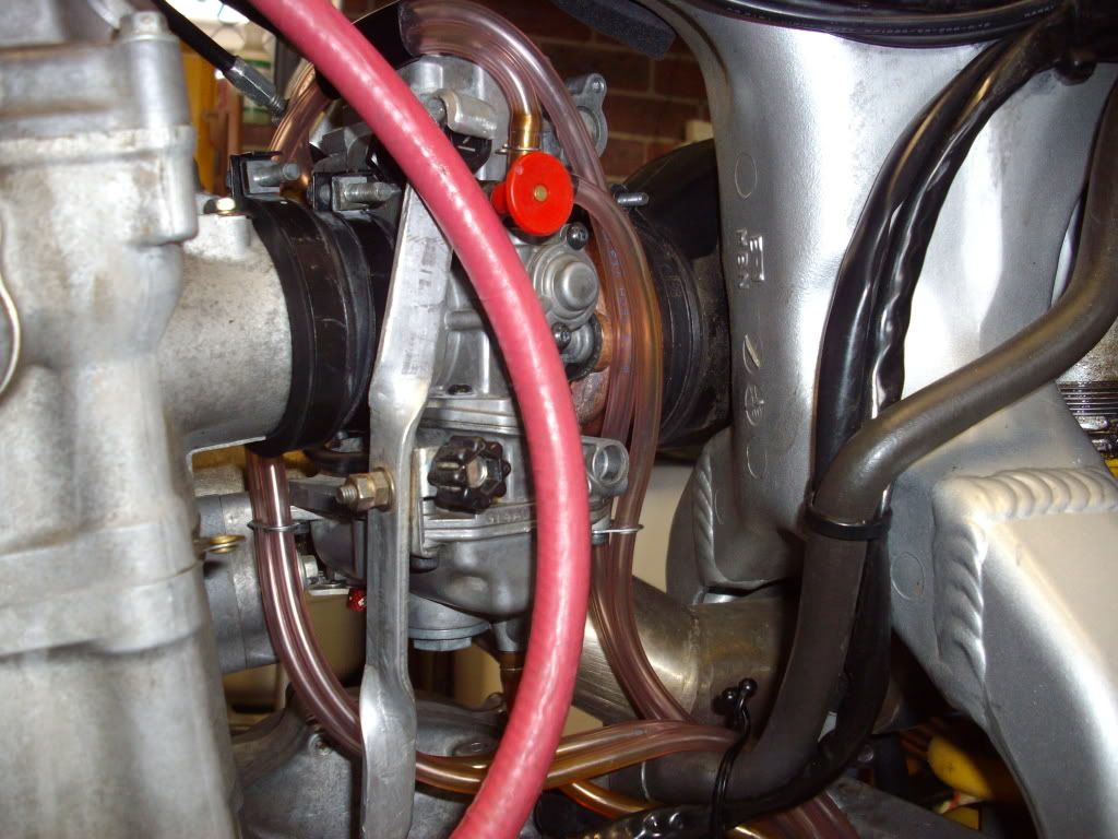

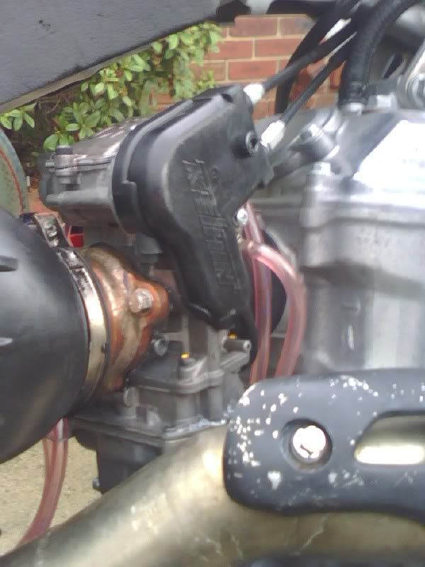

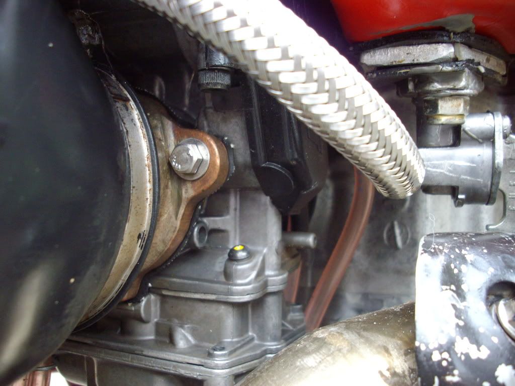

Morning all, This is my FCR41 MX install on the 650r it,s eaey the only real mod. is to remold the clark tank with a heat gun,longer edelbrock cables,homemade air boot adaptor and choke/mixture lever.The crisp response,over rev. is great here are some pic's
