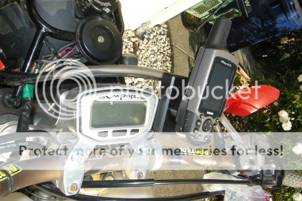

What about the XRS only top mount setup? Can it do the rearward mounted post? That way I can mount my Vapor to the front.
I really like the way he mounted up this computer. Anyone know if I can buy this bracket? Or do I have to make it my self? Looks like it's hooked to a BRP damper/clamp setup.

Michelangelo wrote:What about the XRS only top mount setup? Can it do the rearward mounted post? That way I can mount my Vapor to the front.
