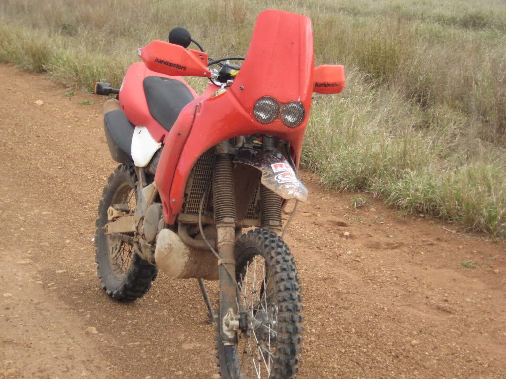

Nice big lights aj,you got the stator rewound?,are the xr models that go to asia the same as the oz model 650rs?.....heres a photo of my xr with twin headlights off a ktm,got a 500 watt stator so it powers them up ok

giantpiggy wrote:Nice big lights aj,you got the stator rewound?,are the xr models that go to asia the same as the oz model 650rs?.....heres a photo of my xr with twin headlights off a ktm,got a 500 watt stator so it powers them up ok
Tell us about the 500 watt stator modification!
Hey mate...well...i believed they are the same...the euro specs version...with those squarish signals,big original square headlamp,rear extended subframe....and about how much watt the stator gives,i am clueless at this point.
Do you think that the size of the lamp matters?eerr...well...mine is err...bigger than yours....
