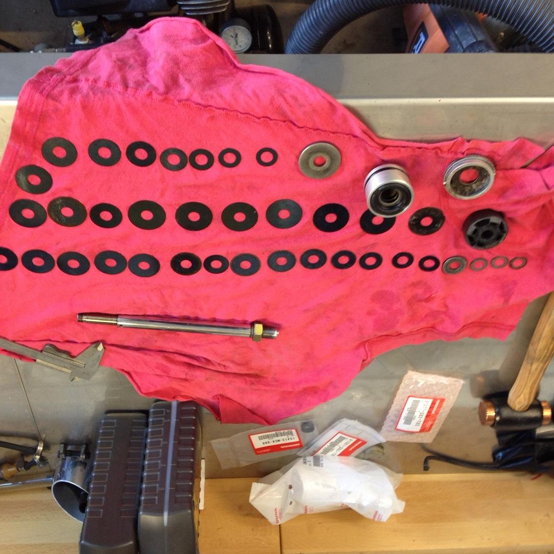

Took it all apart.

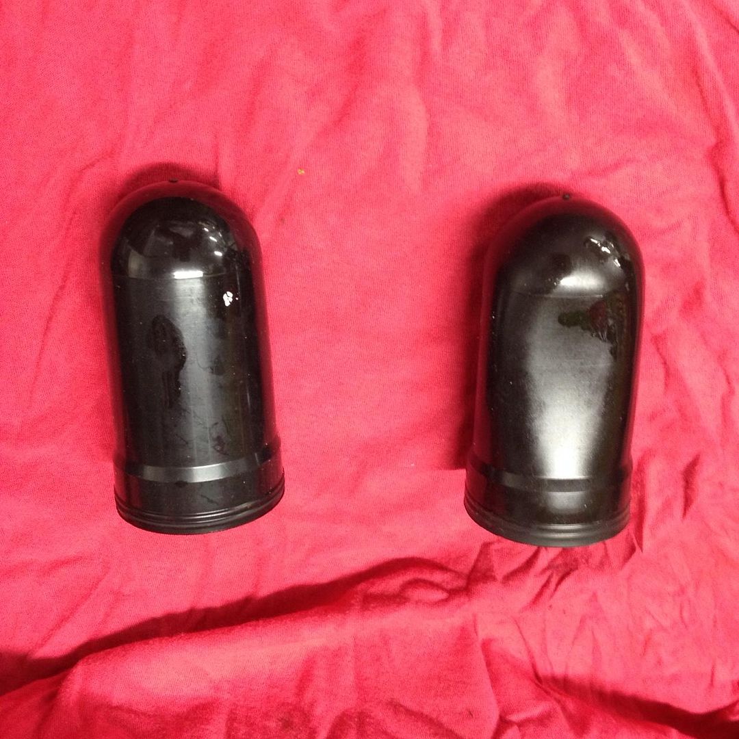

Changed the bump stop and bladder.

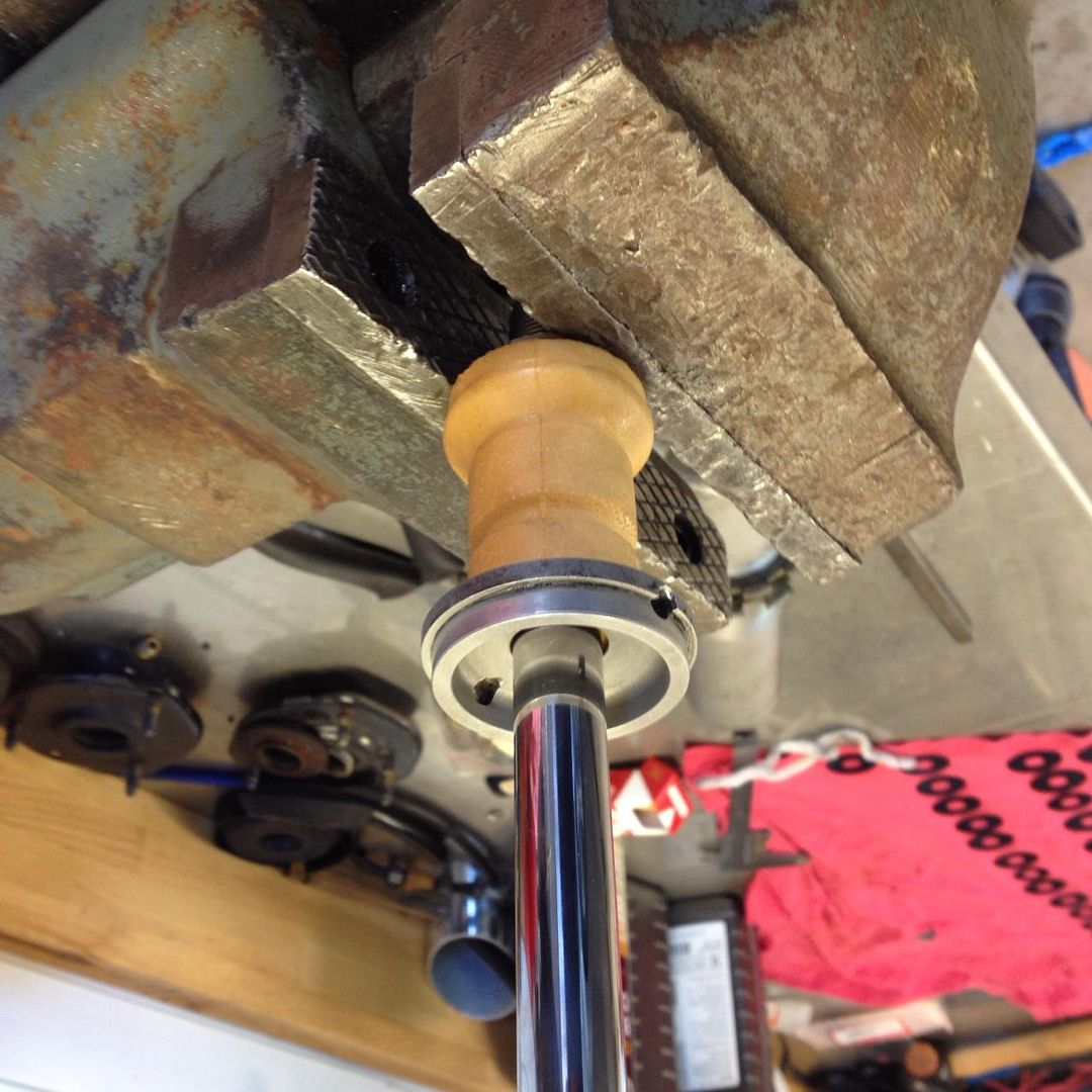

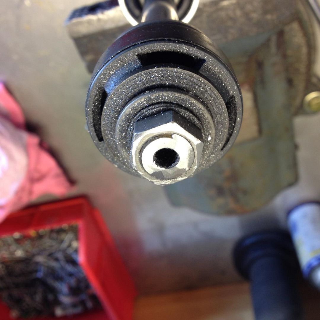

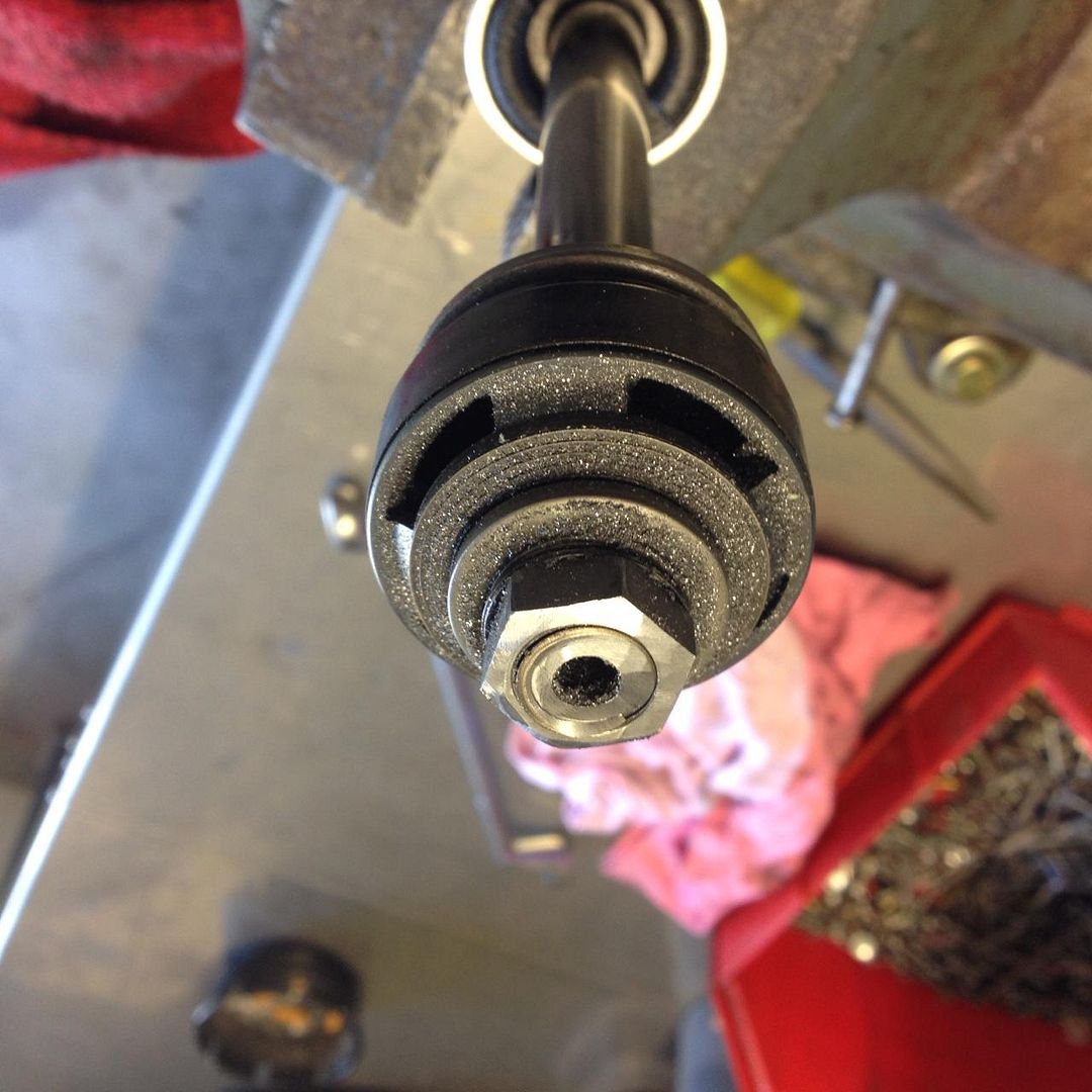

Unstaking shim stack. What a delicate affair this is.

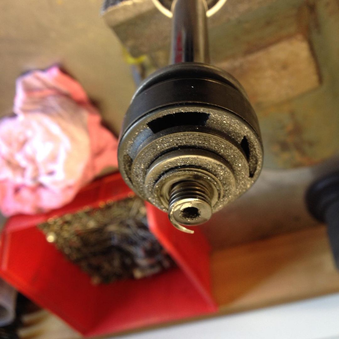

Chasing threads on rod nut
Voila

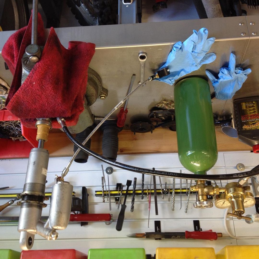

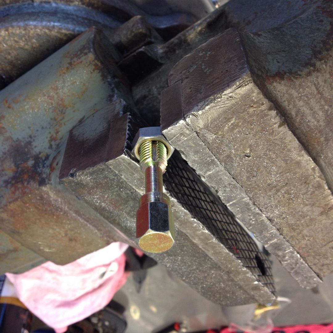

Lastly filling up with Nitrogen. 142 psi is what the manual calls for. Those Japanese Honda engineers are so precise.

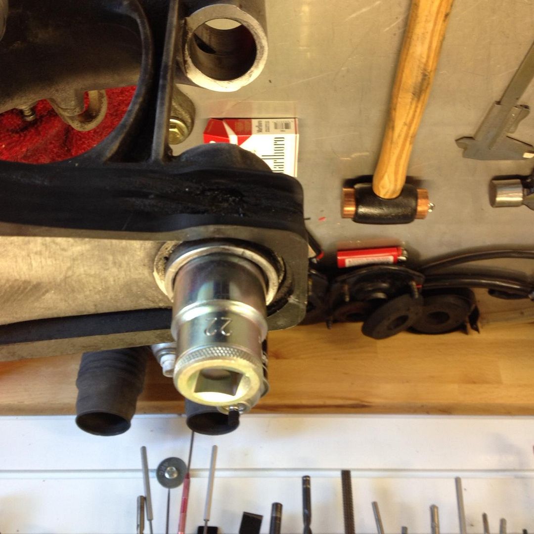

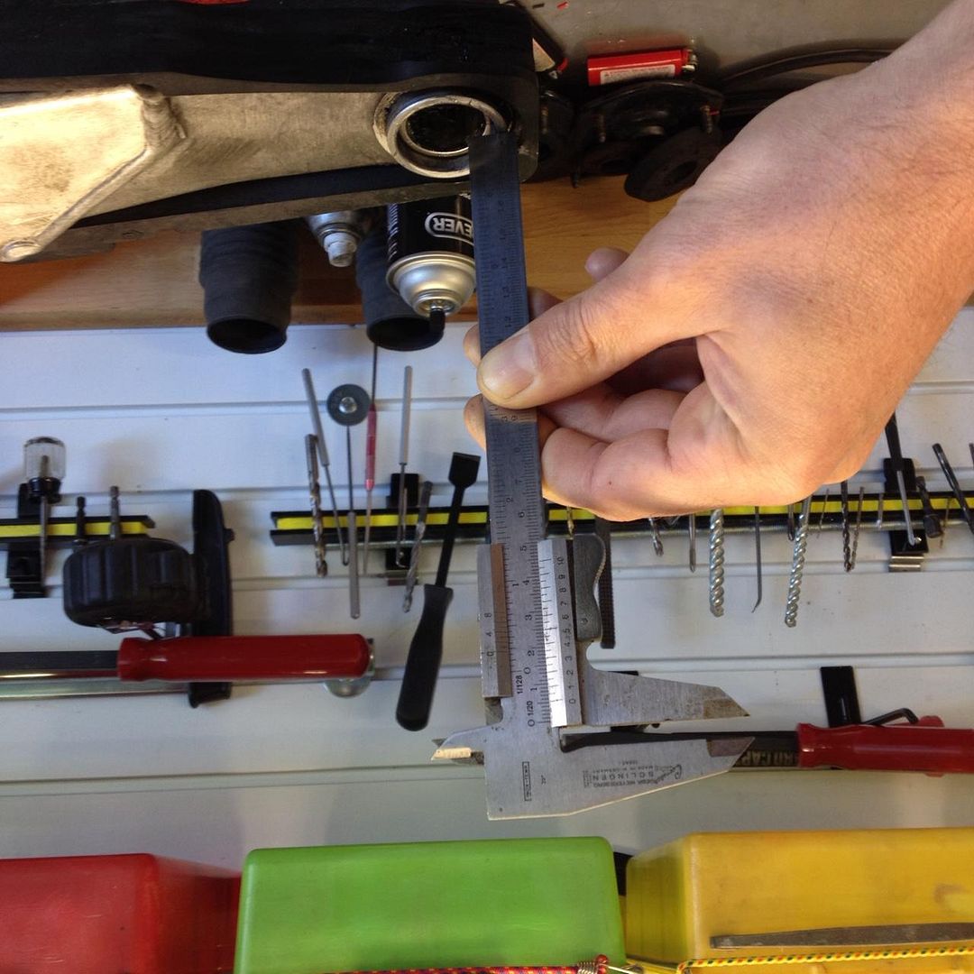

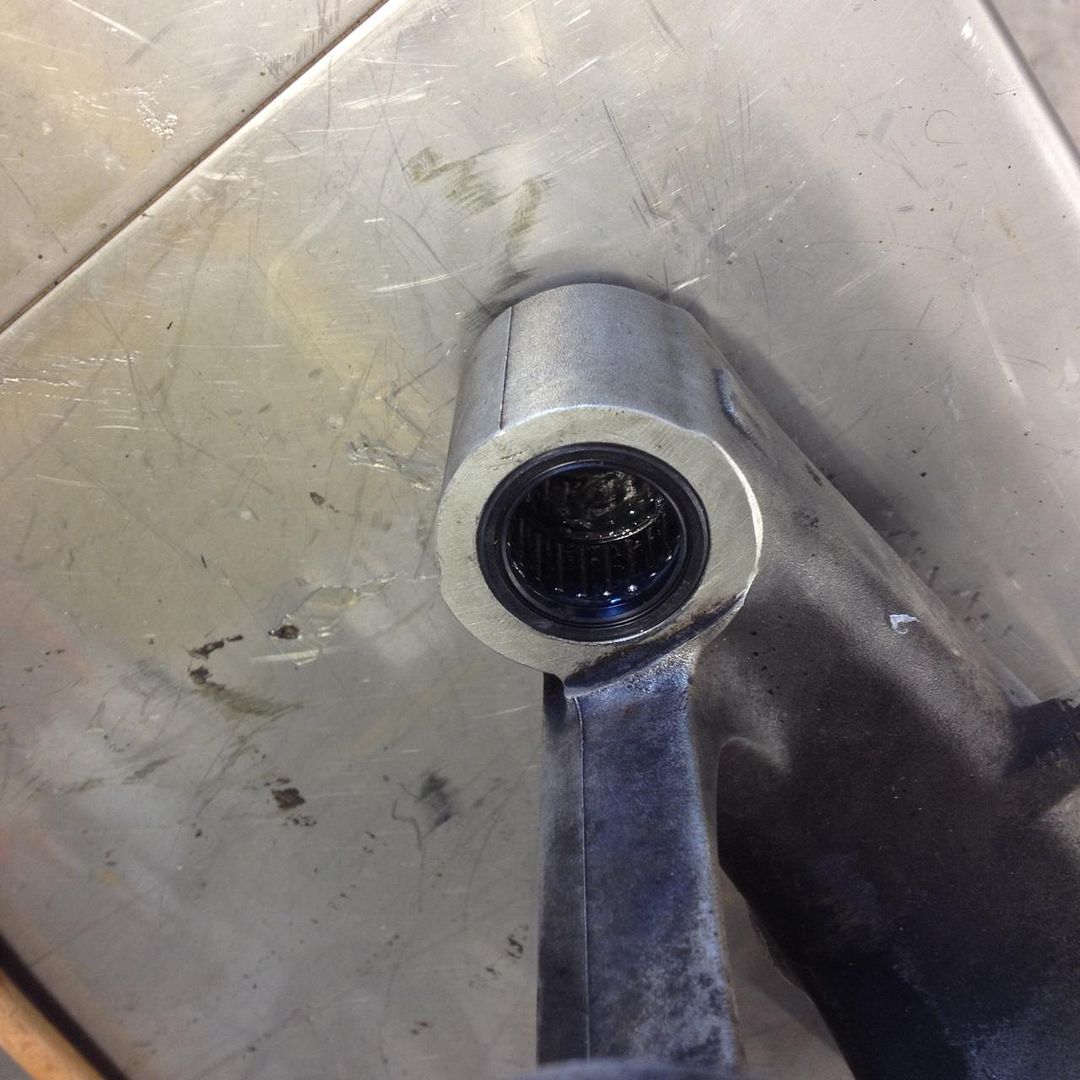

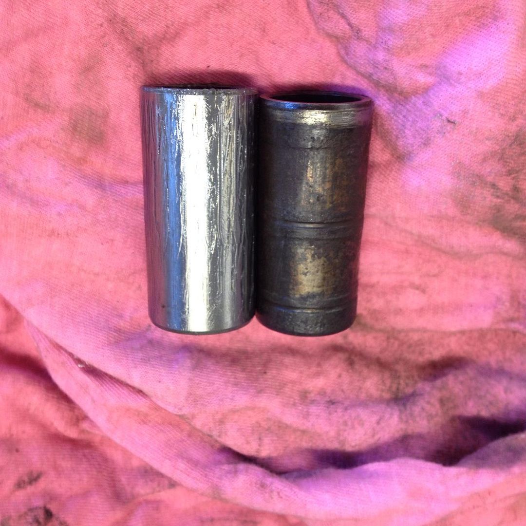

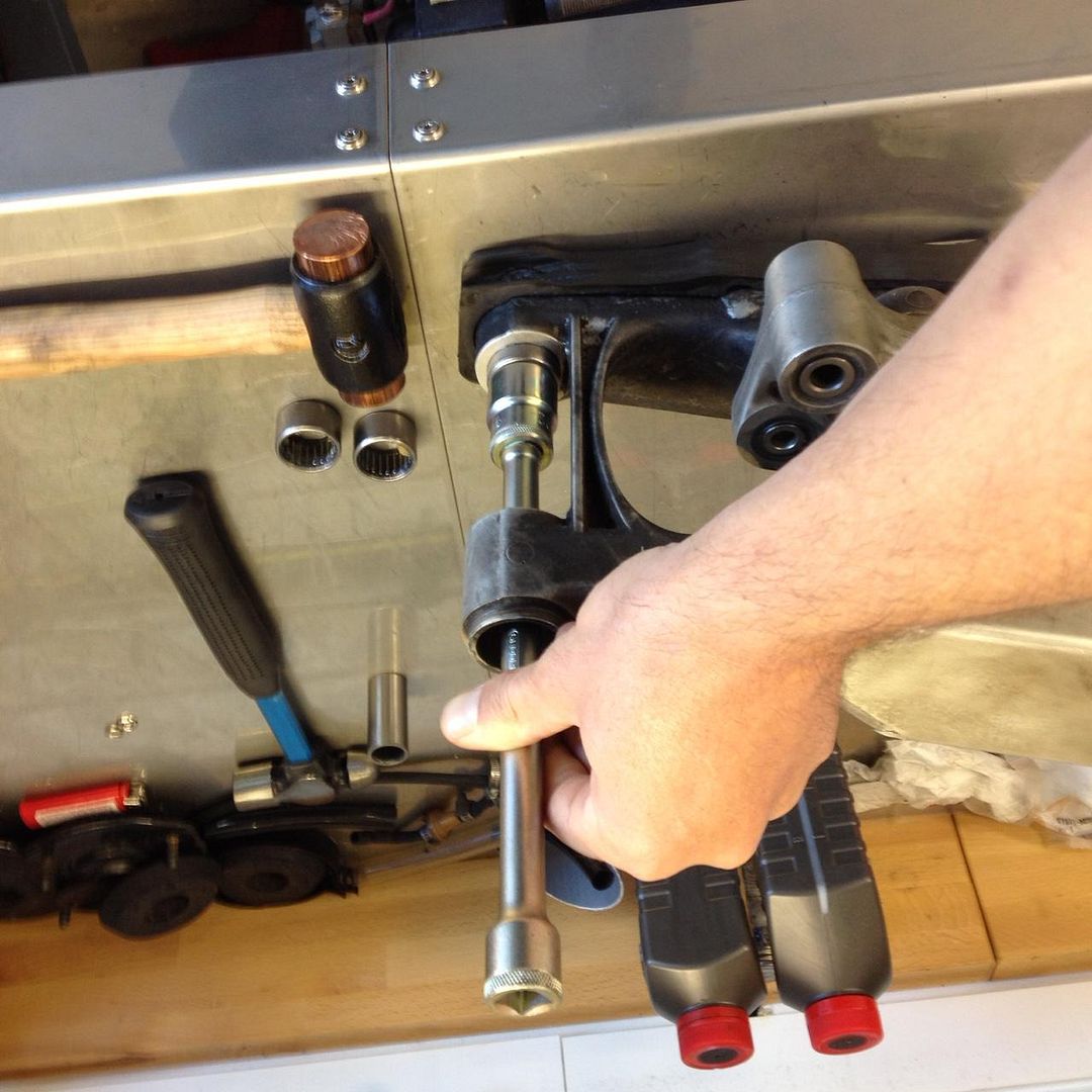

While I had the shock out I decided to inspect the swing arm needle bearings. Good this I did. They were shit.

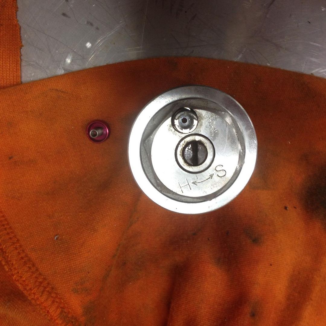

Lost the little air relief valve on one of the fork caps. Damn thing just disappeared. I think the previous owener had these Moose racing valves so I'll get another set of them.

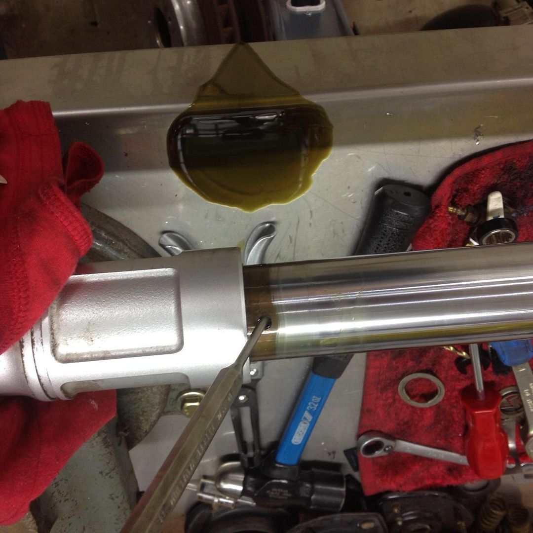

Not having the damper dissasembly tool I just used a punch inserted as pictured below to loose the damper rod from the sleeve thingey. Worked like a charm. It's not clamped very strongly otherwise I would not recommed doing this as it might damage the surface of the damper tube.
