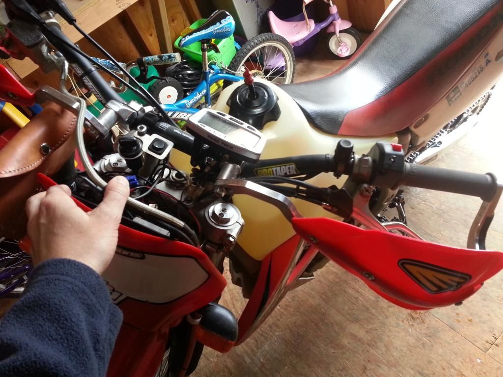

Post  ooeddym on Sun Apr 27, 2014 11:56 pm
I am also 6' and 175 and just installed new bars, risers and hand guards.  I went with the ProTaper woods high with 2" Roxx risers which worked with stock throttle cables and clutch cables.  I can almost stand straight up with this setup.  The compression release cable had to be routed under the bar instead of going through the mounts and the throttle cables had to go behind the bar.
MasterE is running the ProTaper factory Suzuki/KTM bend, both setups are very similar.

Post  Mad Frosty on Mon Apr 28, 2014 6:26 pm
That setup its much higher than mine - better if you do loads of stand riding , this subject its a very personal thing as everyone have a different riding style , conditions , ....
Ooeddym i am looking at the pictures and your oem cables look too tight with that setup , my setup is lower down compared to yours and the oem lenght motion pro cables are just right but if i went little bit higher i would deffo need to use the longer set that i have , not telling you what to do but you might get some problems down the road with the cables so tight , please dont get upsett , just trying to help you . Smile

Post  ooeddym on Mon Apr 28, 2014 6:50 pm
You are correct, they are almost taut at full lock. I had to make sure they were routed the most direct route and not wrap around the bars. Im looking at putting a flat slide carb on it which will come with new longer cables. I do like the high bars for standing up.
