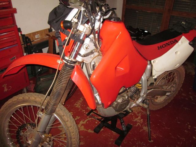

Post  SkidMark on Wed Oct 16, 2013 9:45 pm

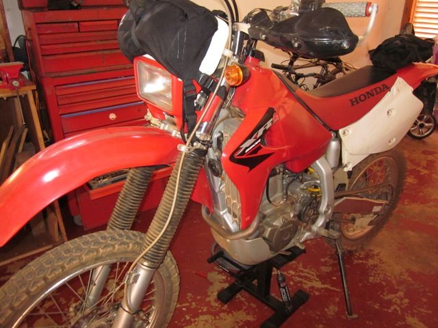

Before
After

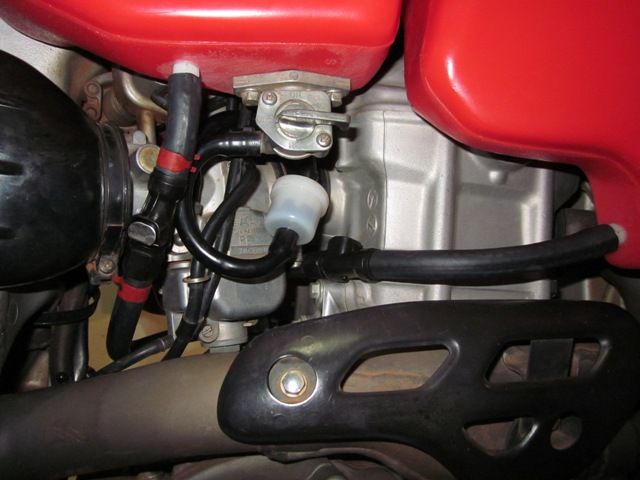

Vacuum pump

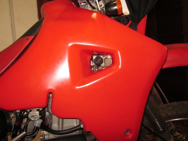

Fuel tap and quick disconnects

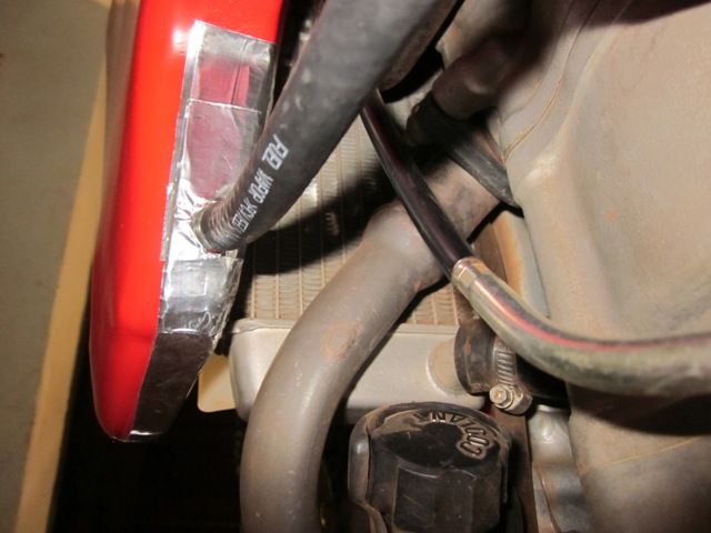

Aluminium tape to protect tank from exhaust heat.  (Exhaust wrap on order.)

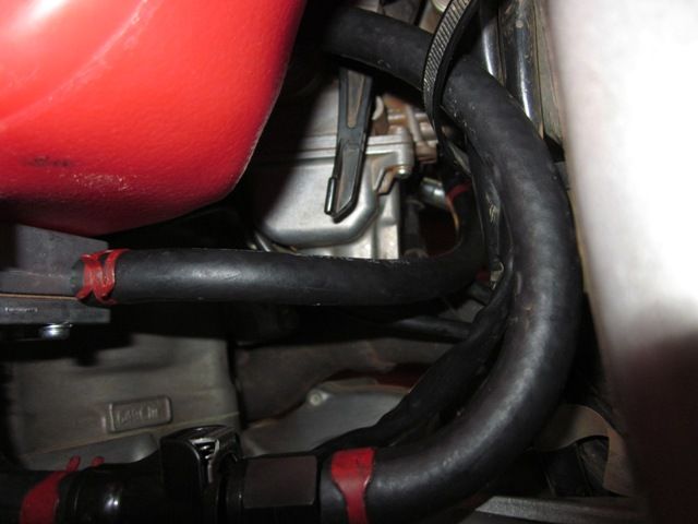

Choke lever access possible but no way to get to idle adjustment while on the bike and barely when you are off the bike.
Ignition key installation still fits

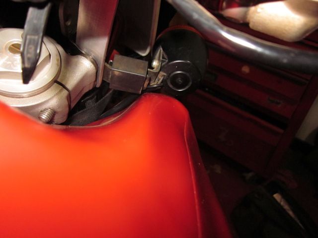

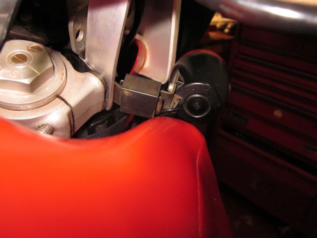

Indicator brackets contact tank on full lock
Slight bend in bracket fixes that.  The plastic indicator housing just touches but the rubber mounting flexes so no issue.

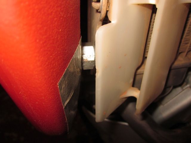

Spacers provided are too wide to fit so large nuts installed temporarily  till I can turn down the spacers at work.  (Tanker Brace on order)
Can’t get front seat mount to slide into place – anyone else had this issue?  Might just velco for now to help keep in place but no huge deal.
So all in all I'm very impressed with the quality and fit of the tank with the two minor exeptions regarding the seat and spacers...I would say the quick disconnects are a must else you can not take the tank off with fuel in it.

Got same tank, and if you bend the seat (stock-std seat) it'll slip into the pin on the tank.
That alu tape will come off though, know it.
Those quick connectors I hope have checkvalves in them? If not (in both halves) then you'll cause a fire when taking it off of a hot engine in the field - but it seems you know this already BRP smile

BuRP wrote:Got same tank, and if you bend the seat (stock-std seat) it'll slip into the pin on the tank.
Hey,
Just managed to get the seat on properly.....bit of bending and some slippery stuff around the pin and alot wiggling.  Hopefully now its on it will take a 'set' in that position.
I have lots of tape at work.....had got exhaust wrap coming too.
Got the right check valves as well...although I busted one already...I had it sat in such a way that when the kick start returned it broke a bit of the plastic that holds the sliding metal plate in place and so the plate, spring and pin all popped out....good job I had ordered a spare Cool .
Only concern is that starting will be a pain without access to the idle screw.....I usually tweak that up a turn or so to start from cold....do you have any problems Bart?

Edited: yeah, some wrap around the headers is a good idea, I had that too. Thorns will ravage it though, but then again it remains a dirtbike after all, it adds to the character BRP smile

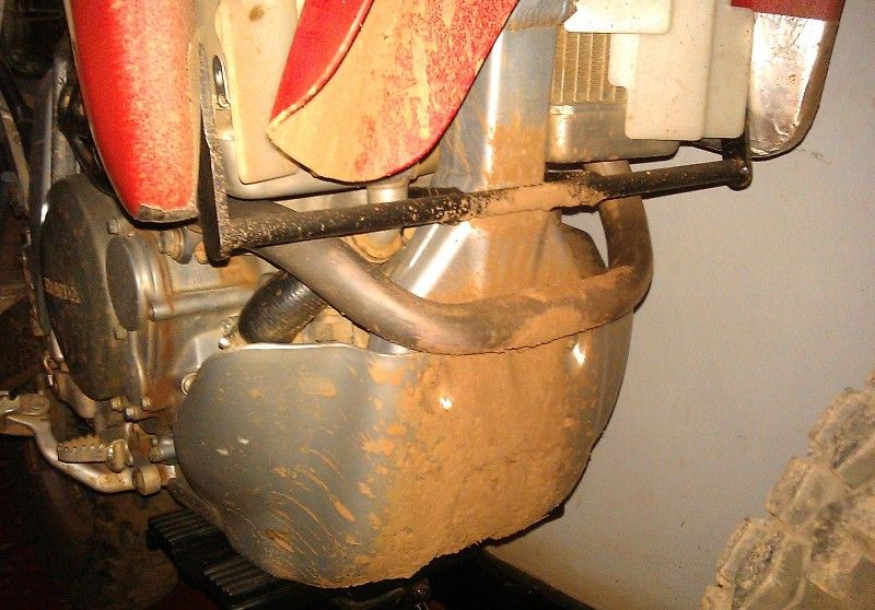

Tanker Brace
Post  SkidMark on Sun Nov 24, 2013 6:12 pm
Well, got the tanker brace and installed it - only slight issue I had was getting a spanner (wrench? I'm multi-lingual Cool ) on the engine mount bolt head as the rad that side is slightly tweaked - oh also I had to put a thinner washer on the engine mount bolt as there weren't enough threads to go through the nut.  No big drama though.  The brace is a great bit of kit, really well designed and manufactured - thanks Hodakaguy.
